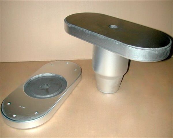

Slide gate plates are key functional refractories installed in the ladle or tundish slide gate system to control steel flow during casting. As flow-control components, they are subjected to extreme thermal, chemical, and mechanical stresses: high steel temperatures, erosive flow, oxidation, slag attack, mechanical abrasion, and frequent opening/closing cycles. Their lifespan directly affects casting sequence length, ladle turnaround time, production cost, and operational safety.
Improving slide gate plate life is therefore a critical objective for steel plants as it increases sequence casting lengths, reduces refractory consumption, and enhances steel cleanliness. Achieving long service life requires a combined approach involving raw material selection, plate design, production technology, preheating practices, operational discipline, and metallurgy control. This article provides a detailed and practical guide on how to extend slide gate plate life in modern steelmaking operations.

8. Regular Inspection & Failure Analysis
To continuously improve slide gate plate life, plants must analyze failure modes:
Common Failure Mechanisms
  1. Thermal shock cracking
  2. Chemical erosion from slag/steel
  3. Oxidation-induced damage
  4. Mechanical abrasion
  5. Misalignment wear
  6. Grooving or channel formation
By identifying root causes, engineers can adjust:
  • Materials
  • Designs
  • Operating practices
  • Preheating procedures
Continuous improvement is the key to reaching optimal service life.
